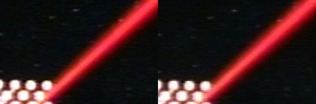

If you think your Canopus ADVC-100 is so great then I might be bursting your bubble if you take a look at the following website:Originally Posted by jdjbuffalo
http://www.geocities.com/fredthompson6/
Take a look at the LINK entitled "FlyVideo3000 vs. NTSC capture comparison Screen Grab"
Here is the image you will be seeing (this is a smaller slightly more compressed version)
On the LEFT you have a capture from a PCI TV tuner type capture card using a lossy codec (it doesn't say but I'm assuming HuffyUV) and on the RIGHT you have a capture that was done with the DV codec.
BIG DIFFERENCE if you ask me.
- John "FulciLives" coleman"The eyes are the first thing that you have to destroy ... because they have seen too many bad things" - Lucio Fulci
