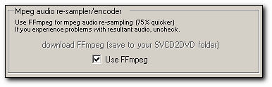

Morning campers. I've been playing with ffmpeg over the last couple of days and i have to say i'm very impressed. I've decided to include the option of using it as the mpeg audio resampler/encoder.
if you don't have it (i.e are updating) you can get it by following the link:
make sure it it saved to your SVCD2DVD folder
Ok whats the story about it? Well it does the audio resample step in 75% LESS time than before. Depending on what you are doing, size/output-wise, you can expect the overall process to be around 50% quicker!!!
Now this may come at a cost (but i don't think so) - the audio may not be to everyones standard. If this is the case don't use FFmpeg. IMHO i think the audio is equal to the old method. I've spent hours on this and i can't tell any difference. FFmpeg is my recommendation - I will be using it.
Do an update to 1.5.1383.23557
BTW I just did a 2 SVCD movie (1.6 MB) from mpg -> VIDEO_TS. It took 26 mins and the sound was awesome.

Once you get this version up & running use the link in the options screen to get ffmpeg (as shown above). This is a single file: ffmpeg.exe and should be saved to the SVCD2DVD folder so that svcd2dvd.exe & ffmpeg.exe are in the same folder.SVCD2DVD v2.5, AVI/MPEG/HDTV/AviSynth/h264->DVD, PAL->NTSC conversion.
