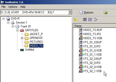

  5. If you still cannot rip using DVDDecrypter,etc then try IsoBuster.
    In the left window click on the red(ISO) symbol,then in the right window right-click on the bad VOB(s),extract to HD:

    ISO Buster Pro in UDF mode works MUCH MUCH MUCH better than the free ISO only version. Buy it from the creator. He's a nice guy, I've spoken with him before, support his project, it's only $30, please don't pirate his work. Probably one of the most valuable tools anybody that works with DVDs can own.
