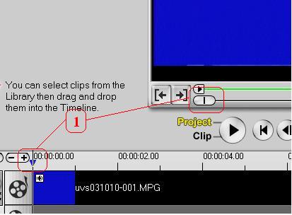

    1. Once your video is loaded on the timeline, move the blue cursor or jog bar to where you want your final video to begin.
    2. Press the Mark-in button to tell the program this is where the video will begin.
    3. Switch to Storyboard mode by pressing the top gray button in the lower left of the screen.

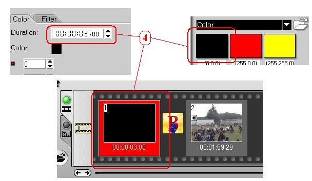

    4. Now to make a fade in, we need a black screen. In the library menu (top right) select "Color". Drag the black color box down and over to the left of your original video storyboard box. A black box will appear to the left of your video, and a transition will appear between the two clips.
    Also the Duration of the black is set to last for three seconds if you look at the upper left screen. You can change this duration if you like.

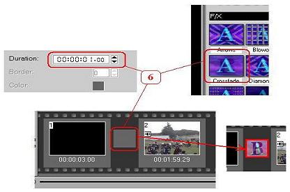

    5. Since we want a fade in and not this transition, click once on the transition icon between the two clips and press the Delete key. The transition will disappear and a blank box remains.
    6. Go back to the library menu. If the F/X library is not already displyed, select it. Find the transition named "Crossfade" and drag it to the blank transition box we just cleared. The Crossfade icon will appear once you drop it there.
    Save your project and run it. The video will start as a black screen, and fade into your video. You have just edited your video, joined it with a black screen, and had it fade in from the black screen. Six steps. What do you think?
