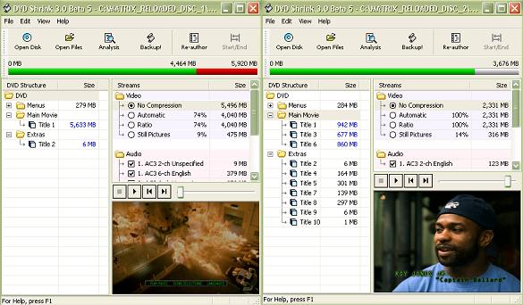

  12. Disc One (main movie+simple menu) is less than 6GBG why don't you just shrink it down to 4.37?
    Disc Two (extras,...) is 3.6GB (my favourite boxer on the pic)
