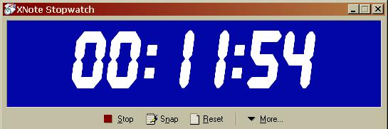

    Xnote Stop Watch is shareware, man. I really like this program. You can run it on your desk top while Window Media Encoder records it.

    Tommyknocker, how do I record the stopwatch from my desktop? I am interested in learning how to do this. Is Windows Media Encoder the same as Windows Movie Maker? I couldn't find a way in Movie Maker to record the desktop.
    Nevermind - I downloaded the Media Encoder and it works great for screen captures!

    Windows Media Encoder is a different program, but it is freeware as well. I may make a guide for it as well, if the AviSynth (also one of favorite applications) solution does not pan out. There should also be a way to make a digital clock count for sporting events like basketball and football, in my opinion.
