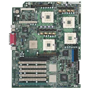

Here is some super computer power for you:
http://www.tigerdirect.com/applications/SearchTools/item-details.asp?EdpNo=588480&Sku=...7100&CatId=177Hope is the trap the world sets for you every night when you go to sleep and the only reason you have to get up in the morning is the hope that this day, things will get better... But they never do, do they?
