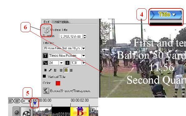

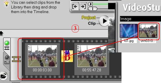

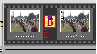

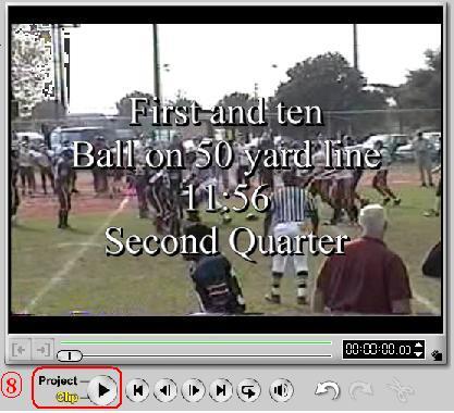

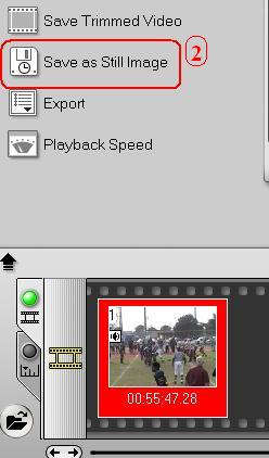

    To make a title, use Video Studio 7.
    1. Once you have it up and running, load your first clip, and drop it into the first Storyboard slot.
    2. While the video thumbnail is highlighted, ensure you are at the beginning of your video, select Save as still image. The first frame will be saved as a frozen frame clip.
    3. A thumbnail representing the new clip will appear. Drag it to the spot left of your original video and drop it there. This inserts your frozen video in front of your main video.
    4. Select Title. The storyboard will change to a timeline.
    5. Click and hold the blue cursor and move it near the beginning of the timeline (far left).
    6. Click once on the "T+" symbol in the upper left corner. A rectangle will appear in the preview window with a flashing cursor. Type in your subtitle and select the "T+" symbol again to exit entering titles. If the subtitle does not appear in the preview window, move the blue cursor from step five a little to the right.
    7. Select the gray button next to the top movie reel symbol to return to the Storyboard mode. Highlight the small transition effect symbol and hit Delete. You will not need a transition effect for the video portion.
    8. Select Project and then the Play button. The video will be frozen as the Title is shown. Once the title disappears, the video runs normally.
