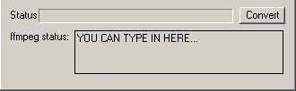

1. Open the GUI and click on "Browse" for the audio source. Then click on "Cancel" (without choosing any files) to close the browser window. You get this error message:
2. Probably not a problem, just suspect this shouldn't be happening: It is possible to type in to the area "ffmpeg status:" at the bottom of the GUI. See picture:
