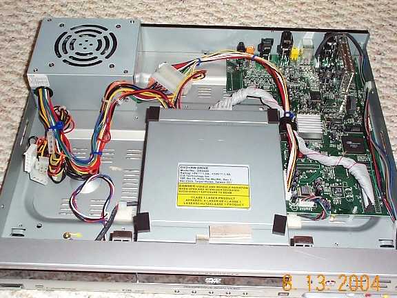

  6. My unit and the disks were always pretty hot when recording. This could cause problems after months of use. I noticed some black residue on the top of my cover when I removed it initially. This tells me something was getting pretty hot.

    My drive runs hot too.
    After reading the first update, I removed the top cover and now I find the disk is too warm but NOT hot after recording or editing it.
    The heat problem seems to be caused by a solid steel platform the drive sits on.
    The platform blocks the cool air comming in from the vent holes below it.
    I just installed an 80mm computer case fan (purple LEDed).
    Next, I'll cover some of the vents to optimize the air flow.
    If the disk is still too hot, I'll probably drill large holes in the platform so the cool air can hit the drive.
    Having just exchanged my first unit (March 31) that died for another (April 10) and since their are no security seals on the screws, only green sealer inside the unit on screws, I'm running it with the cover off.
    If you don't want to do that power off the unit with the switch on the back. The one that died was still warm over the power supply even after being off 18 hours. The power supply is still running of course when the unit is off or the clock wouldn't display the time. Settings seem to be retained since t hey are battery backed up with a battery on the Mainboard.
    What a difference in heat!
    I'm tempted to just leave it like that and see what happens in terms of durability.
    WARNING!!!! Don't do the cover off if you have kids around. I got some good tingles off of the innards when I was using my digital temerature probe (My Finger in other words) to see how hot things were running with the cover off.
    I'm on my second disk in a row, the drive is only lukewarm, the other innards are cool. If it was a heat problem killed my first unit, My suspicion anyway, Then this will cure that. I don't want to mod teh case with fan(s) so I can run with the cover on at least until the 90 day walmart return and/or the 90 warranty runs out.
    Hopefully this helps someone.
    Cheers
  9. zleepy, my feeling is that the drive isn't too hot with the cover off, however it could run cooler if it had a cooling fan in it like some brand name drives do.
    For those that don't want to open the case, burn one disk an evening, power off with the AC switch on the back let it cool down between burns I noticed that the first disk is a lot cooler than the second disk.

  15. this Cyberhome unit has recently been selling for as little as $229. Avoid this product!!!!! mine froze and discontinued functioning soon after the 90 warranty expired. this unit overheats, has format errors, and is built from cheap components. customer service does not respond either to email or by phone.... after seeing how prevalent these problems are with Cyberhome, i only have 3 words for you cyber-smuck guys for selling this crap.... "class action lawsuit."[/b]
  16. I bought my CyberHome 1500 back in March and it died two weeks ago (ugh, only 5 months use). The symptom was similar to what I've seen a couple others post: the display shows 'CyberHome' and no functions work at all.
    The problem was the power supply board. The 12V line was putting out 13.5V and the 5V line was 4.5V; apparently this is not enough to get the DVD drive to start spinning (my first check was to hook the DVD drive to the ATX supply on my computer to see if it would spin-up ... it did).
    Fortunately, I was able to wire a standard computer ATX supply in its place. The mainboard power connector (PS1) has the pinout printed on the board (though the wire colors do not correspond to the ATX standard). I lost the front panel display because it requires a 25VDC line (from the original supply) in order to function. But, it's not really needed.
    OTHER DETAILS: I ended up using a 'micro ATX' power supply (because I had bought a couple for cheap, and they're much smaller than a normal ATX supply). I bought an ATX interface connector and pins, cut the mainboard power cable at the old power supply and wired it appropriately. Pin#13 on the mainboard connector (PS1) was labeled 'PW_CL' which, initially, gave me some trouble (didn't match any label for the ATX supply). Apparently, it was a line back to the old supply telling it to turn on (with an active HI, 5V). It wasn't needed so, I didn't connect it to the new ATX supply. The ATX supply has a similar line (PS_ON) but, it is 'active LO' ... I tied this line to a GND wire so that the supply would power up when the main switch was flipped.
    Take care.

  18. FWIW (Knock wood!) Mine is still working fine. I suspect a heat issue as the first one died very quickly and always ran hot. This one from april 10th 2004 has always had the cover off and runs cool, the drive gets warm in use and the disks slightly warm, the unit I ran with the cover on they were hot when removed.
    I suspected back in April that it was heat issue and still believe so. The record quality is good, it does the job I bought it for, It's paid for , blah, blah, blah, etc.

  21. You still might want to remove the cover, they run very hot with the cover on. Mine is still running fine since I replaced the first one under the Walmart defective exchange. I also turn off the AC power switch on the back. Even when off the unit is warm from the standbye power useage. If you feel yours you'll see what I mean. If they'd put some colling slots and a fan in these units they'd have had a real winner.
