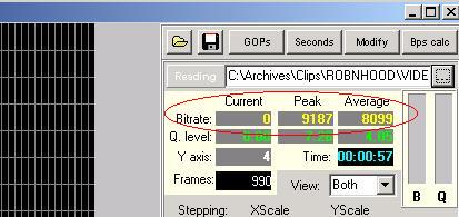

    Originally Posted by DJRumpy
    You can verify your MPEG output with DVTool.
    I need help with that. How do I get some graf with v0.53 that is available for download ?
  9. Member DJRumpy's Avatar
    Dallas, Texas
    Senior Moment...{*Doh!*}
    It's Bitrate Viewer, not DV Tool...
    Impossible to see the future is. The Dark Side clouds everything...
  10. Originally Posted by DJRumpy
    Any help with that ? I have version 1.5.054. What should I setup to see graf correctly ?
  11. Member DJRumpy's Avatar
    Dallas, Texas
    Just open your MPEG, and allow the software to parse completely through the mpeg (may take a while). Note the PEAK value used:

    One subtitle stream need around 10 kbit/s in average, so it's not that much. Great idea regarding usuing a CD-R to store the audio. I think I'll try that. I can fit one our uncompressed wav 48 kHz stereo as wav file on a CD-R! Thanks! With compressed audio I can use higher video bitrate.
    Regarding mainconcept encoder 1.4 I have not tested the bitrate peaks. But the more I use the encoder the more happy I am. It gives better quality than TMPGEnc in my opionion. Yesterday I tried it on Peral Harbor, 3 hours on a DVD-R with full resolution and still very good quality! The 2-pass VBR option gave a very accurate filesize, almost as accurate as CCE.
    Ronny
