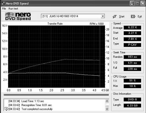

    Ok so I figured this disc has been covered alot lately, but I'll post up what I found. As usual YMMV, always buy a smaller sample before jumping into huge bulk orders... blah blah blah.
    UPDATE: It was suggested that I try the latest version of CD Speed from Nero and I did so. The review itself was done on a friend PC. Since that Time I have put the test disc through my own computer with the latest software and the results are VERY nice. Look at the bottom of the review for the Nero CD-DVD Speed image.
    I'm actually fairly impressed with the current matrix media, its by no means perfect, but when you consider the price its not really so bad. I'll post up the pictures and let you see for yourself. My webhosting is awful at directlinking pictures so I had to really shrink these things down to
    make them fit.
    Also as usual the first Nero picture and the Kprobe picture are from the same movie I've used for every disc I've reviewed like this.
    First the media code:
    00 6C 00 00 01 40 C1 FD 9E D8 52 00 02 F7 0E 0B .L...@....R.....
    77 88 70 00 03 00 00 00 00 00 00 00 04 00 00 00 W.P.............
    00 00 00 00 05 AA A2 22 22 20 01 00 06 0B 0F 12 ......."" ......
    (Notice its the one that defense first ran into, this gibberish code does seem to represent a breaking point in the development of the disc. If you do order that code is what you hope to see)
    Notice that the media does not have a steady curve, meaning it never really gets a "High speed" read rate, but also notice that it doesn't really have any bomb outs either. Thats the first time I ran into something like this on a media, while not awsome, its not that bad either as it gets to a rate more then high enough to play the disc well.

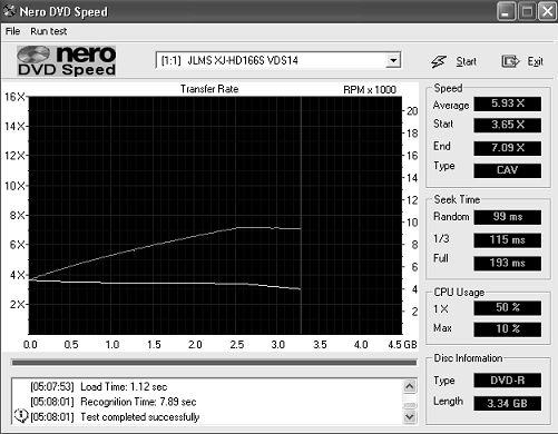

    When I first ran into this I tried another to make sure... different movie.
    Same thing. Interesting... but by no means fatal. Out of the 8 Matrix media I've burned from this current batch (tested every single one) only one burned with the proper curve you would normally see. Like I said, not kickin rad, but not a deal killer either.

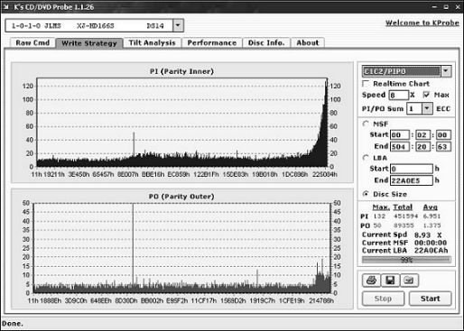

    Ok now for kprobe.
    Not bad at all... over all pretty decent considering where Nero tops out read speed wise.
    One more thing... because of a recent discussion about breaking media I gave it a shot, the matrix disc takes quite a bit of pressure to break, but when it does it shatters, quite violently in my case (stupid disc pieces all over the room) After doing so I pulled the reflective layer back from the ink layer and unlike some reported the dye did NOT come off on my fingers. I know that hardly helpful to many but I wanted to mention it.

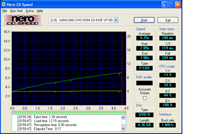

    I, too received several of these from Shop4tech.com to test. My transfer rate tests (using Nero CD Speed vs. DVD Speed) were similar. No horrendous drop-outs anywhere, but not perfect either.
    Some of the disks would only burn at 2X but not 4X. Others burned OK at 4X. In the case of the 2X burns, the test results were usually better than the 4X ones.

  5. Basically your two results were the same as mine. It's clear as I mentioned early on..that the 3rd formula disks are much better then the first gen disks.
    @Flaystus, your Kprobe results look great, but i've never even heard of NERO CD SPEED results like that....to me that's odd. My Nero CD Speed results show in some cases a "slight" drop...but there has always been gradual increase in speed up until the drop point. Your results were more "paralell" so to speak......I think Ebenton had some Nero CD speed results which were more similar to mine. Of course, he has a DRU-510A....as I do. When Disturbed posts his results of the 3rd formula...then I guess we'll see because he has the Pioneer as well as you.
    All in all..it's good to see the results are basically the same for all of us with these 3rd gen disks. I have a small amount of Matrix 4x DVD+R's here i'm currently testing...I'll post on the quality of those after I'm through.

    Yeah basicly the end result is instead of continuing to climb.. most go to about 7.8x. It just levels out at around 7x. Not a big loss really. The good part is the results have been STABLE over my burns, which now total 9. The only odd ball disc so far scored BETTER then the rest.

    This graph from CD Speed is pretty typical of the most of the Shop4tech Matrix 4X DVD-R disks that I tested.
    Many thanks to defense for helping me figure out what the hell I was doing.
    Defense, did you notice that flaystus' tests were with DVD Speed and not CD speed?
    Anyway, here's a PNG of a typical test:
  8. @ EBENTON...yes, I noticed flaystus is using NERO DVD SPEED....I've seen him post from Nero Cd Speed as well. Flaystus...have you tried Nero Cd Speed with the same disks you've tried Nero DVD Speed? Nero CD Speed seems to be updated more...and being that it handles the reading of DVD just fine..not sure what the purpose of DVD Speed is.
    Also, ..my graphs are pretty much typically like yours to ebenton....very slight jags which absolutely won't affect playback. The big ones is where you have to be concerned...and even then....most of the time they'll play with those too....it's just obvious that you want as few as possible.

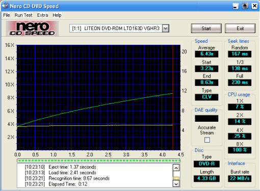

    Ok I've used my own drive and the latest Nero CD-DVD Speed. You can see the chart at the bottom of the review. wow. Better yes? BTW that was the same exact disc from teh first test. Also I've now burned about 15 of them. The only "Coaster" I had looks like it got a little damage on the top in shipping somehow. All in all every single one I've loaded into the burner has came out great.
  17. @flaystus...that's really interesting man..because I had the same damn near "PERFECT" results with about half of the last batch. I just didn't get around to posting the results..but now that I see you did...I definitely agree......what's funny is after my first, almost excellent graph..I had to do a double take...because I said..."NO...this can't be a Matrix disk"...I thought I mistakingly burned a TDK/Memorex +R 4x Ricoh by mistake..because those are the only two disks currently on hand where I get perfect results with Nero CD Speed each and every time. Anyway, even looking at Ebenton's results..those slight drops and peaks are meaningless..they absolutely WILL NOT affect playback on any standalone....but I do have to admit..seeing perfect nero cd speed charts is very encouraging. And even more encouraging is that another formula is right around the corner to make the disks even better.
