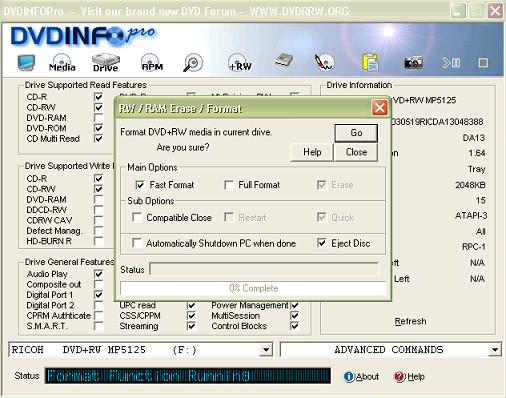

  5. Thanks for the reply
    DVDInfo doesn't erase DVD+RW only -RW thats why, if you look carefully, the erase button on your post is greyed out. You can only format the disc, is this the same as erasing (i.e what is the difference between erasing and formating?? I just want it to be like "new" / completely blank)
    When I saw the format option in DVDInfo I thought it was going to format my DVD like a large stiffy (ie read/write functions like nero incd UDF format) so never used it.

  9. Originally Posted by Stnfx
    LOL!! That obvious that I don’t HUH!
    So why are you telling me to look at the pic carefully?
    Anyway DVD+RW doesnt need to be formatted before the first writing.
    The drive can do background formatting during burning.
    click here to learn about formating/erasing with DVDInfoPRO
    https://www.videohelp.com/forum/viewtopic.php?p=632218
