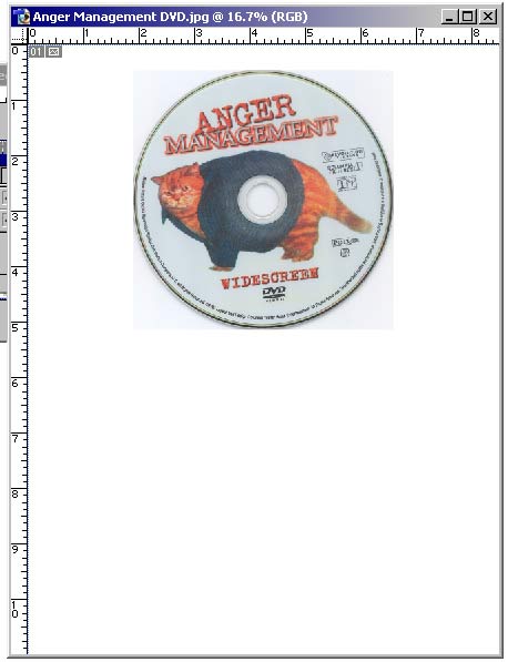

Step 7. Remove printer margins
Most printers can not print to the edge of the page, so if you leave the canvas now, your printer will either clip the image off or rescale it to fit within its printable area. To insure that it clips of the blank areas and does not resize, will clip it so your printer doesn't need to choose. Most printers have a 0.25 inch minimum margin (check your printers manual or look online). So we will reduce our canvas size by that all the way around. Again click on "IMAGE" -> "CANVAS SIZE...". Then minus off 2 * the printers margin (2 * 0.25 inch = 0.5 inch) from the height and the width. Leave the anchor point in the middle. Then click "ok".
You should now have an image that looks like this:

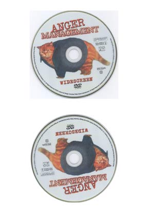

NOTE: If you want to print 2 images on the same label sheet, you can repeat the bove process and instead of printing you rotate the image 180° and paste it over the top of your first image. (You might need to "cut" out the white area on the top image to see the first one...) But when your done it should look like this...
