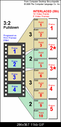

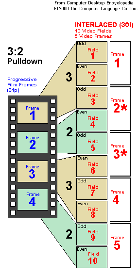

    I agree with most of the above. They convert 24p (23.976p) to 29.97 with telecine (extra pad fields) as follows:
    If you want more explanation ask more.

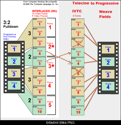

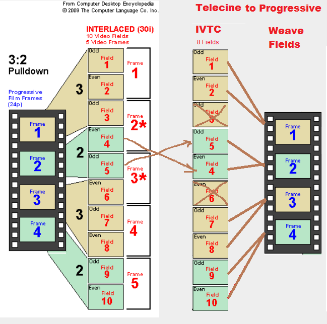

    When you say the pad the feild to ad frames do you meen they just ad Copies of Frames?
    In the drawing you will see an extra field is added for frames 1 and 3 to make 29.97 telecine. For inverse telecine, those fields are removed.

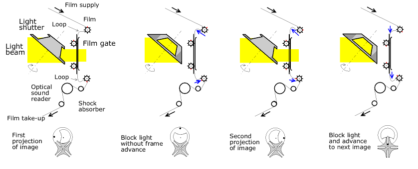

    Here is another graphic of how a 2x gate works.
    http://en.wikipedia.org/wiki/Movie_projector
    PS: the shutter graphics seem reversed to me but the idea is right.

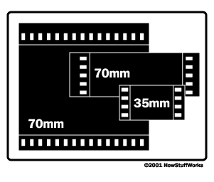

    Most 35mm film formats used for TV use a vertical feed orientation. Some motion picture production process film and IMAX use the sideways feed.
    Anamorpic 2.35 to 1
