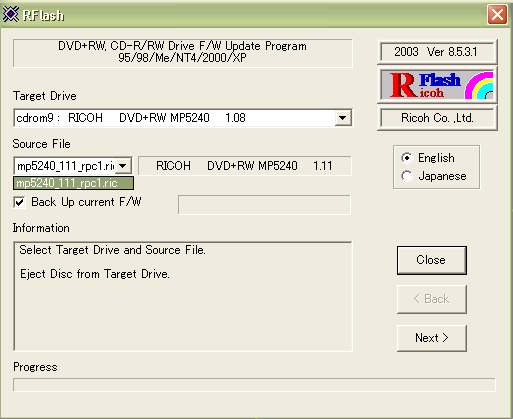

  6. Update your firmware from 1.08 to 1.11 and do a full format again, it might help.
    You stop me again whilst I'm walking and I'll cut your fv<king Jacob's off.
  7. Ill give that a try thanks tompika . Ive downloaded the new flash utility
    from forum.rpc Can some one point me to a newbie guide to update my firmware please
    cheers DAZA
  8. It can not be easier.
    http://ext.ricoh.co.jp/dvd/asia/support/download/how_win.html
    PS Be aware that that packet writing softwares, DLA can screw up DVD+RW (and bitsetting) big time. That might be your problem too.
    Uninstalling DLA,... solve these problems instantly

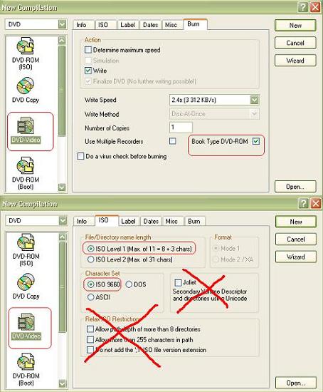

  10. If you burn with Nero DVD-Video template always use these settings!!!
    http://dvdshrink.info/guides.php has cool nero guides

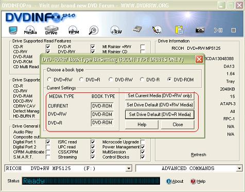

    If you use other software than Nero, its very important that you set all booktypes to DVD-ROM with DVDInfoPRO before burning.

  12. I use Nero5.5.10.50 but also RecordNow and DVD Decrypter
    The firmware and the Flash Program have to be in the same directory.

  13. immmmm my file from richo is M72 1111.ric and does not work
    i see yours has drive model etc where can i get that?? cant see it a ricoh
    cheers DAZA
  14. found it tom all updated and all is good worked on one disk i think the other one is crap Thanks very much to all for ya help
