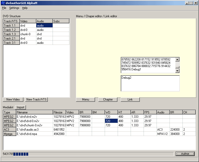

  10. I'm a MEGA Super Moderator Baldrick's Avatar
    NightWing: email it...maybe I could use it.
    alpha screenshot
    import media fixed.
    multiplexing fixed.
    now only some authoring stuff...

    This is great, I love to see a more powerfull tool than IFOEdit for authoring (which is already very powerful) with command-line!

    Basic authoring is done(add audio,video and author to titles)...i'm now working on linking and basic menus....and it takes a lot of time to make a good gui for all that.

    So it's possible to use multiple VTS? Interesting! Have you found a way to convert subtitles to xste format?

    Yes...you can have multiple vts.
    No I haven't found out how to fix the subs yet.
    Aren't anyone else testing dvdauthor?? or making a gui???
