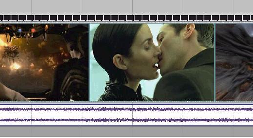

I was right .. i downloaded that link above .. and dropped it on vegas time line and worked perfect -- nothing special to it ... audio and video all there ..
here is a screen shot ..
thats great thatnks! what version of vegas video did you use? i think i have the old one vegas video 3.0 this version won't let me open it. it says that the file is an unsupported format. maybe it doesn't see the quicktime codec. is there something i can do?
i used version 4 with the latest update ...
