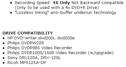

  2. Now this Ritek 4xDVD+R info is confusing.
    Because these are 2.4xburners and 1xstandalone recorders

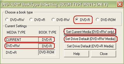

  12. Woohoo!
    I got it to work! Thanks to TOmpika and DVDInfo Pro.
    Yes, the default booktypes were all messed up with this burner.
    For some reason, the DVD+R were defaulted to +RW, like DVDINFO said.
    Well, I never had a dvd player to test here, so I kept having to give them to my friends to try, which makes the trial and error process SLOW.
    I had just tried my AOpen +RW disc in the SD2700 and it didn't work.
    So, I did a compliant(?) erase using DVDinfo.
    Then I forced ALL the booktypes to DVD-Video.
    I reburned the +RW with DVDDecrypter.
    I then put it in my friends SD2700, and it worked! And this drive isn't even +R(W) compatible!
    Beautiful. Now I am going to try my Memorex +RW, and see if they will work. Basically, if they play on this player, then they should play on almost any player.
    Although, even though the DVD+R book type defaulted to +RW, the previous disks I burned DID burn as DVD-Video. Hmmm. Well, more testing with that media tonite.

  15. So, I tried the Memorex +R using Nero DVD-Video.
    I left booktype alone in Nero, and set it to DV-Video in DVDINFO.
    It wouldnt play in my loaner Toshiba SD2700.
    But, today I received a new progressive scan samsung 5 dvd changer!
    I tried it in that and it works!!!
    For the heck of it, I tried some of those first run burns before setting booktype in DVDInfo, they wouldn't even play in my new DVD.
    I guess the booktype was just screwed on my burner's factory settings.
    All fixed now!
    And as far as that +R not playing on the SD2700, that should be expected. It's not rated to play any + format. And, it does play +RW with booktype set to DVD-Video, which is more than you could even expect from that drive.
    Thanks Tompika. I think I might actually send some $$$ DVDInfo's way thru paypal. What a great tool! It should be bundled with all burners, especially these RICOH drives that allow bitsettig.
    Man +R(W) is such better technology than -R (allowing bitsetting, mt.rainier support for RW). I am worried that they may go the way of the beta
    Hooray! The thread that never ends may be over!

    1. Leave the default booktype settings on ROM.
    2. All programs burn the default booktypes except Nero
    Nero wants to control it so you still need to check the ROM booktype option box.
    Happy burning
