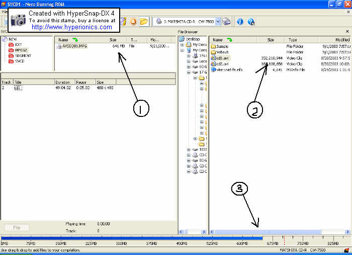

  2. this is a pic of whats happening...
    1 - 646MB on the future burnt CD
    2 - 352MB of the .avi file im converting
    3 - blue bar is way before the red line

  11. Funny thing is that this problem only occurs if the burn is slightly below the burning limit. If you add another file and have overburning activated the overburning window pops up and you can continue as usual.
    My recommendation is that you add another "dummy" file to get passed the troubled disc size and make slightly overburned disks until the fix emerges.
