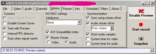

If sync issues were the only problems that you have with iuvcr, try checking these settings.
Under options>avi mux settings, make sure that interleave is set to none. Under that, the "avi compatability index" box should be checked. This actually has nothing to do with synchronization, but some programs will take forever to load video, without the index enabled. Set the master stream to audio, under that.
Under options>synchronization, check "sync stream using offset." Under that, check "stream offset" and set it to zero. That will let iuvcr offset the stream automatically. Finally, check the box under that, "short audio samples." That takes samples smaller chunks of audio at a time, to help with synchronization.
That should take care of major sync issues with iuvcr.

i disabled indexing and the problem still exists, i will give iuvcr a go over the weekend

i gave iuvcr a go and it still drops the 3 frames.
