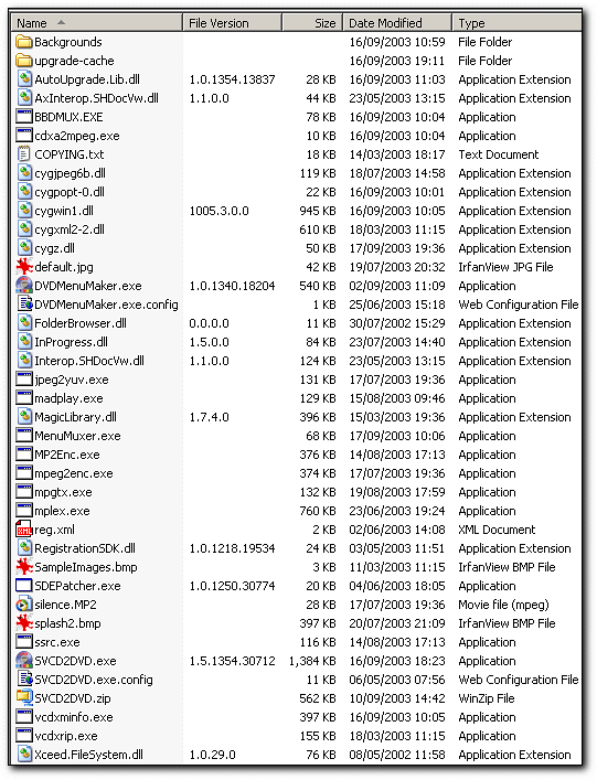

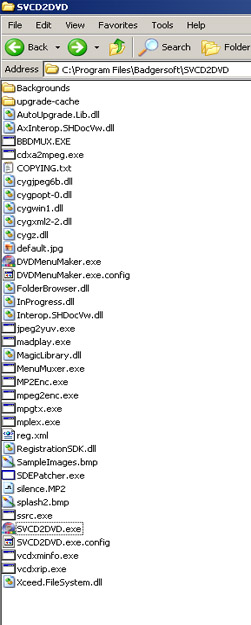

can you screenshot the folder containing SVCD2DVD.exe
