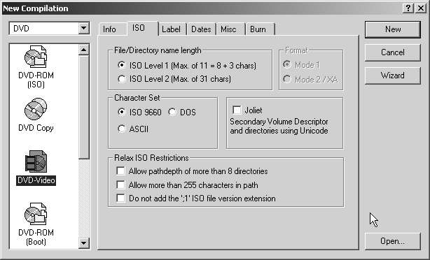

I'm using the normal DVD-Video option (version 5.5.10.42) with following set up
I tried Nero (same version) with those settings and burned at 2.4X to play it safe. It worked! I can hardly believe it.
