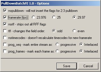

Get the GUI version of pulldown.

You not only have to get rid of the flags but change the frame rate
also. the NORFF may have fixed the flags but not the frame rate. -
I have both restream and woofsoft pulldown but I'm not sure what settings to check. The orginal MPEG2 file has a 29.97 fps, I don't know what is the frame rate after I did the pull down. is it still 29.97 or something else? What frame rate do i have to change it to now? 29.97 fps? Can these 2 programs do IVTC InVerse TeleCine as well?
no it didn't work. The play time did not reduce. Thanks though. Any more suggestions would be appreciated.
The frame rate is 29.97 fps on both the original file and the pulldowned file. You can try this test. Create a 29.97 fps MPEG-2 clip, pulldown it, you will see that the play time is lengthened, now what can you do to the pulldowned file so the play time goes back to the original. Stripping the RFFs didn't work for me. Could it be the pulldown is irreversible when done on a 29.97 fps MPEG-2?
