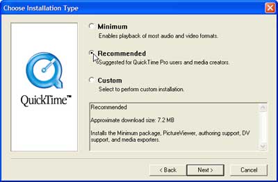

However, if your camera captures video clips in .mov (Olympus digital cameras are one such group), you will need to install QuickTime version 6.3 or above on your system in order to import them:
1. Download the installation file for QuickTime 6 from Apple and run it.
2. IMPORTANT! Make sure to select the "Recommended" installation type. Otherwise, the audio portions for .mov video clips will not be extracted.

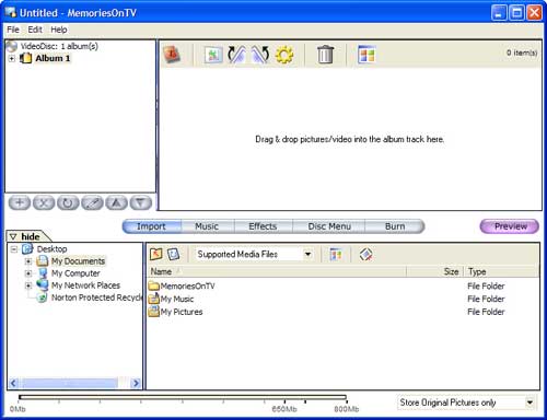

3. Start MemoriesOnTV.

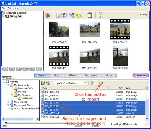

4. Import your pictures, video clips and music files into your albums.

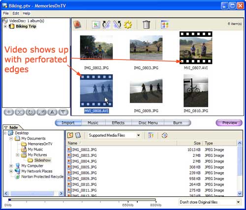

5. The imported video should show up in the thumbnail view as a frame of picture with simulated perforated edges. Otherwise, it means that MemoriesOnTV does not recognize the video clip format, and the import is not successful. See troubleshooting later for more information on the possible causes.

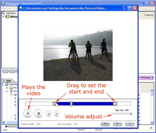

6. Doubleclick on a video clip to bring up the customization window.
7. In this window, you should be able to playback the video clip using the button controls. Also, the video clip starting and ending points can be trimmed as necessary. The volume of the audio track in the video clip can be adjusted as well.
8. Once satisfied, click "OK" and proceed with customizing the other video clips or still pictures.

12. The audio is absent from my .mov video clip
This is most likely caused by only installing the minimum setup for QuickTime. You will need to select "Recommended" installation type. Reinstall QuickTime again and the audio should work.
