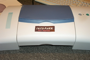

    I have hit a snag that I do not think can be fixed! The Z25 is essentially done. Except for one thing. When it prints onto thick media (like the caddy), it does not print a perfect circle. It prints an oval that is 1 mm shorter on the top and bottom (a total of 2 mm) so if you can live with that kind of tolerance, then it will be out soon. I need to check a few things, and finish photos and write the guide. This one involves some precise grinding to move the printhead height, so it is a much more advanced skill level than the Epson mod. There is also a bunch of messing around that the Epson do not need.

    I have now confirmed that the following Epson Stylus Color models should work with minor changes:
    400, 440, 600, 640, 660, 740, 800. Also possible are the 860 and 1160. These were confirmed by looking at the repair manuals. Some minor differences may be present!

    Just went through my Skidmark pictures, need to take a few more. Then I will start writing the guide! Might be late Friday night, but most likely sometime this weekend.
    If you are good with tools, and understand the warnings that I made in the previous posts, it would be a safe bet to buy one on Friday. Models that will work Z25 & Z23 without changes. The Z605 and Z705 and Z35 should work, but you will need to make some allowances for what might be a slightly different case. Best bet would be to buy a Z25 or Z23. Just make sure to open the box before purchase. It should have 2 ink cartridges, 1 color and 1 black! The software and paper you might want, then again you might not. You could also spend some time making Test papers the size of a CD, you will need a couple to fine tune the caddy after cutting and glueing. Paper is cheaper the disks, and easier to get.
    Bring it home, test it to make sure it prints! Make sure you have all the tools listed in the Epson guide. A small round metal file would be best for the printhead height adjustment if you have one. Safer than a grinder, because you have more control and won't remove too much material. You only need to oval out 2 holes by 1 mm in height. This is the hardest part of the mod! Not a lot of filing. You will also need a drill to make one hole in the metal chassis. Small like 1/8 inch or smaller. Smaller is better. Some sandpaper might also help, but not absolutely needed. That being for the caddy, and the printer case. Since you most likely do not have the materials to make a vinyl caddy, you can get by with a file on the case.
    The next printer model I want to do is one of the following: The HP 3520, or Canon i250 (S250?) or Epson C40/C42. But I will not be able to buy any until I get a new job. If someone wants to send one of those to me, I'll return it in one of 2 states. State 1, I do not think it can be easily modded, so I send it back with no damage done (I will give it a good cleaning while I have it). State 2, it will be an easy mod and I will return it fully modded with a nice custom vinyl caddy, and a printed mod/user booklet. It just has to work, and have ink in it (at least half of each color and half of black). If you have a broken printer in the above family, I will be happy to try and fix it. Maybe it will work, maybe it goes in the trash. That's also up to you. Just remember, it WILL NOT print onto paper after the mod!
    I'm trying to stick with the cheapest printers on the market! So if anyone is willing, let me know. I find this to be very fun, and it helps give me something else to think about. The Canon is the one that I least want to do, someone has already modded a Canon S200. The 250 is just a compact version I think. No one has any of the Canon or Epson on a shelf for me to look at. I know the Epson C62 and C82 do not look to be easy. I haven't ever looked at the C40/C42, but I do see that it does not use the chipped carts! That's very important!
    Any who, a link to the Skidmark guide will appear in my signature when it is done. If anyone does buy a Z25 today, for the purpose of making a CD printer, please let me know. It will motivate me to get the guide done a little quicker. I think this will be a good printer for this purpose. Cheap and available. The quality should be high enough to please anyone (it is a CD after all, not a picture for display). If anyone knows where to get the ink for this model cheap and maybe a refill kit that they have used, let me know. I'll put that info in the guide also, since eventually the ink will run out. With the price of the ink, you are better off throwing the old printer away, and buying a brand new one! Sad that we now have a disposa-printer
