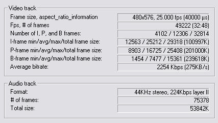

  11. Hi, I'm back and very happy that VirtualDobMod managed to handle these files. flaninacupboard thanx for the tip . It turns out that the files are in mpeg-2 format.
    This is what 'File information dialog' says for one of those 600MB files mentioned before:
    Now, what do you guys think would be the best solution to downsize these files? I'm aware of that certain Mpeg-4 formats aren't supposed to be discussed here but if you think that is the way to go I guess you can p-mess me.

    Looks like you have SVCDs
    . The files are are too big: 4 files, 3x600 MB + 1x170 MB for one hour show
    Too big for what ? The Vdub display says 32 minutes
    that's probably one 600 mb file. Reasonable.
    That means all of them add up to nearly 2 hours
