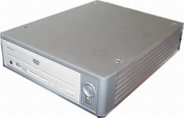

  1. Does anyone know anything about this enclosure? It is esbuy.com model ELFWUSBALUMCL - $129.99
    I have a LG GSA-4040B Thanks!
    -Ricky
  2. Here's an image of it.
    -Ricky
  3. Oops!
    -Ricky

    I'm not aware of this box but it looks really nice. If you want to use it for a recorder, make sure you check the specs and confirm it has a built-in FAN. Also, you may want it to be firewire or USB 2.0, to ensure enough datarate.

    ive got 6 of them and they are very very good -- uses a upgradable oxford chip set ..
    i have only the firewire only version ...
    they have real heavy duty power supplies in them and high quality BB fan ..
    Dec 2002
    I have one also with a combo 1394(Oxford)/USB2.0 interface. It works great. It has a fan and an internal 40W power supply which is one of the few I've found that's beefy enough to power the Sony DRU-500A.

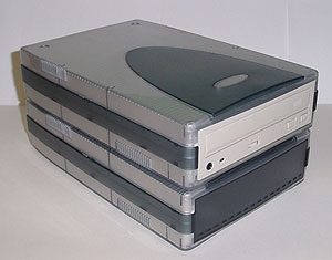

  20. I don't have the one you listed, I have this one,
    It also uses the oxford chip and its got both firewire/usb2. The fan on mine also makes a bit of noise, but not loud at all to bother me. But what I can tell you is that with 7200 rpm deskstar disk I have in there, it definitely needs the case and fan on, if I run it without the cover on, its okay but after 2 hours, its no longer warm to the touch, its more on the hot side and I don't like running it like that cause even my 10,000 rpm cheetahs run cooler after that. But with the cover on and fan, I ran it once for 14 hrs and after opening the case, it was just barely warm.
    So if your okay with running it on the warm side, i'd say its fine for 1-2 hr increments. Anymore, then i suggest turning on the fan so as not to lose your data or have other wierd anamolies happen cause it gets too hot.
