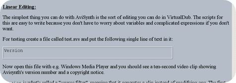

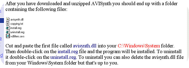

I am trying to play VOB files in V-dub and need help with this article on how to create files
Can anyone explain this in simple terms? How and where do I create the file? Thanks.![]()

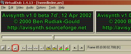

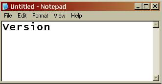

In simple terms, in NotePad.

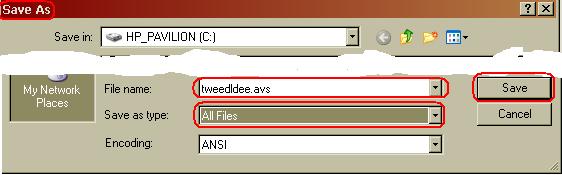

1. Open NotePad. Type in the word Version. No quotation marks, nothing but the word.
2. Save As tweedledee.avs and as a "All Files" type.

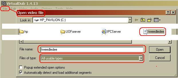

3. Now, go to Virtual Dub and select File-->Open Video File. Select all useable types and load tweedledee.avs.

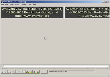

4. Select Play and you should see the Version AVS file.

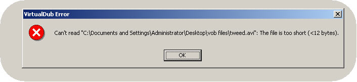

Thanx, I am following your guide ok but when I try to open in V-dub this is what I get.

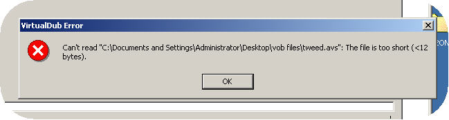

Sorry about that, but it's still the same with AVS

If your computer says the file is too small, what version of Virtual Dub are you using? Also, you may want to try to make your file bigger. Just add a number sign and blank lines to your AVS file to make it look like this and save like before (remember to save it as an "All Files" type:
Version
#Hello. -
File too small is a clue that Vdub has no idea it's a script
and thinks its a real AVI. Or more accurately, the OS doesn't
know to go find and run Avisynth.dll and redirect the output.
version all by itself works good here

create a text file with notepad with the name TEST.AVS
type "version" into the file without the quotes
save it
with Vdub, open TEST.AVS
play the file
what happens ? -
Thanx.....I get this

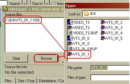

1. Open AVSGEN and select Browse and select your VOB.

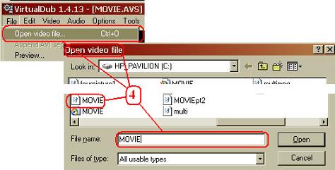

4. Load C:\MOVIE.AVS into Virtual Dub.

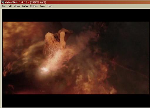

This is my result (Ian McKellen qua Gandalf the Grey, "dusting off" a balrog). If you want to see the AviScript itself, select the AVS tab.

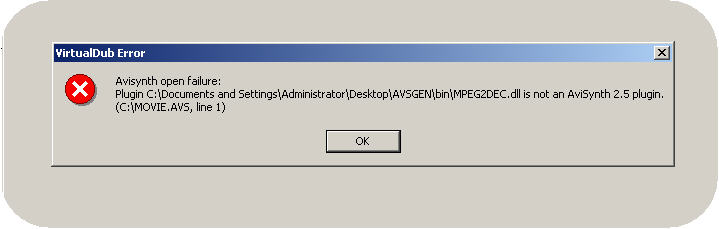

Tommyknocker Thanks, I'm trying AVGEN but can't get v-dub to work with it. I keep getting an error message"Whenever I need to "get away,'' I just get away in my mind. I go to my imaginary spot, where the beach is perfect and the water is perfect and the weather is perfect. The only bad thing there are the flies. They're terrible!" Jack Handey -
What is the error message, and please paste the script AVSGEN gave you.

and this is error messageD:\proof\VTS_01_4.VOB

Yes. That's it. See this line:
It shows which dll your version of AviSynth is trying to use to run your script. However, it seem AVSGEN has an older version. So if you want, you can go into your Windows\system32 dircetory(be careful here), copy avisynth.dll and paste it in the AVSGEN\bin directory.LoadPlugin("C:\Documents and Settings\Administrator\Desktop\AVSGEN\bin\MPEG2DEC.dll")Hello. -

1. Go to your windows directory.
2. Find the System32 directory.
3. Find the file "mpeg2dec.dll"
4. Highlight and copy it.
5. Got to the AVSGEN directory.
6. Find the bin directory.
7. Right click and select paste. If it ask if you want to copy over the existing file select "yes".Hello. -
