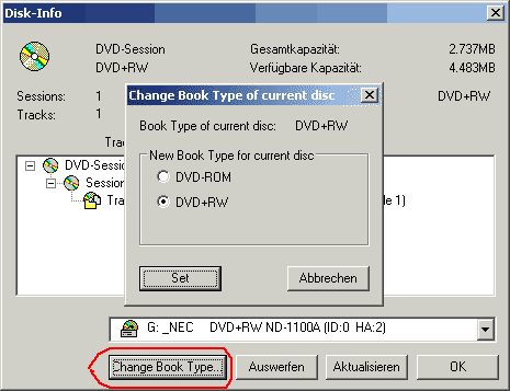

Have you guys seen these pics?
http://etna.rpc1.org/nec/bitset.html
http://etna.rpc1.org/nec/index.htmlYou stop me again whilst I'm walking and I'll cut your fv<king Jacob's off. -

Hi Gil T Pleasure!
I asked Poppa_Meth to post a media info of his burned medias and it shows that his Nec1100 does write ROM booktype by default.
Soon I found this drive can also be OEM Iodata or Dell so its not that strange what you're saying.You stop me again whilst I'm walking and I'll cut your fv<king Jacob's off. -

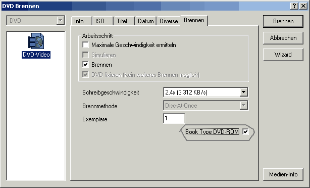

Here's something that I don't get. When I burn the disk with Nero using the DVD-ROM booktype, it still burns it as DVD+RW. I have to go back and change it from DVD+RW to DVD-ROM, but it works after that. I also tried to set the booktype to DVD-ROM before burning with Nero or RecordNow Max for that matter, but they always burn as DVD+RW. I haven't tried a DVD+R yet, so I don't know what that will do.Got my retirement plans all set. Looks like I only have to work another 5 years after I die........ -
Looks like the CMC Verbatim+RW has better reflectivity than the MCC ones
(as the media reviews show too)
Stick with RICOHJPN medias (like the FUJI+RW you use)
Try to get RICOHJPNR +R discs to burn. Most of them are
https://www.videohelp.com/dvdmedia.php?dvdmediasearch=&dvdmediadvdridsearch=ricohjpnr
Sounds like you forgot to change the DEFAULT settings in DVDInfoPRO !
Setting current disc only is not enough!
Although Nero overrides the default booktype settings there is an option to change it.
RecordNow does not touch the booktype settings so you should be fine
if the DEFAULT is set to ROM with DVDInfo PRO !
Hope it helps.

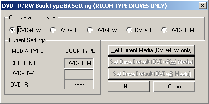

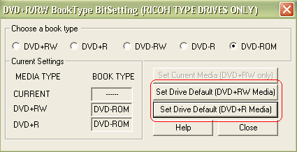

Hey tompika, here's something interesting for you:
Notice that the "set defaults" for +R and +RW are greyed out and wont let me change them. I used the region free frmware v1.64 you recomended. I wonder if it's got errors or something. This may be why when I set the booktype to DVD-ROM in nero, it doesn't work. I have to change it after I burn. Ofcourse this will only work for RWs.
If I wanted to flash this drive again, could I use the standard procedure with the Ricoh FW, or would I have to use the same (fake reverse) that I used to make my Sony a Ricoh? I'm not planing on reflashing my drive just yet. Right now I'm batting 1000 on my DVD Videos compatability using Premiere > Main Concept > DVD-Lab > Besweet AC3 > RecordNow Max > Fuji DVD+R disks.
Thanks for all your help and thanks for that great guide!Got my retirement plans all set. Looks like I only have to work another 5 years after I die........ -

The only way those settings can be ghosted is if the current settings commands failed. Either the bios loaded into the burner is not an official firmware that supports the commands, the hardware required to pefform such is not the same, or packet writing software or similar is intercepting commands to this type of media.
I have seen this happen when such things as DLA, InCD, DirectCD or similar is installed.
I recommend placing the burner into another computer that has no burning software installed at all to show if the fault is in the burner or in the software installed.

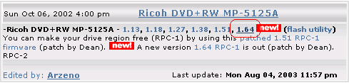

That rpc1 1.64 FW from firmware-flash.com should support it as it does on my drive and it did on Bitrater's Sony120.
