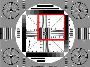

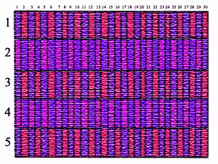

Then I get something like this. Doesn't even talk about resolution, just lines. Read on...
Compare a 720x480 to a 352x480 video. What's the difference? Greater clarity in the left-to-right image. What's I've come to know as horizontal resolution. Horizontal is the across on digital. Vertical is the up-down on digital.
Now if the VHS "lines of resolution" is consider the up-down (220 in place of the 480 from the digital example), then comparing the 220 VHS to 400 SVHS would yield results showing that the SVHS has greater detail in the up-down category. BUT IT ISN'T TRUE!
See these images...
VHS:
SHVS:
Notice the up-down clarity is the same. it's the left-to-right clarity that has gone to shit. The blurring is left-right due to a lack of detail in the left-right span of data.
Lines of resolution appear to be "horizontally" measured, not as in horizontal lines that lay on top of each other.
The vertical resolution is always x480.
The "horizontal lines" or horizontal resolution is the variance.
Giving us the 336x480 or 220x480 and so forth.
The 525 scanlines are not in any way, shape or form "horizontal lines".
And I think I remember my name now!
FYI: this was the original, so you are assured nothing is flipped onto its side:
