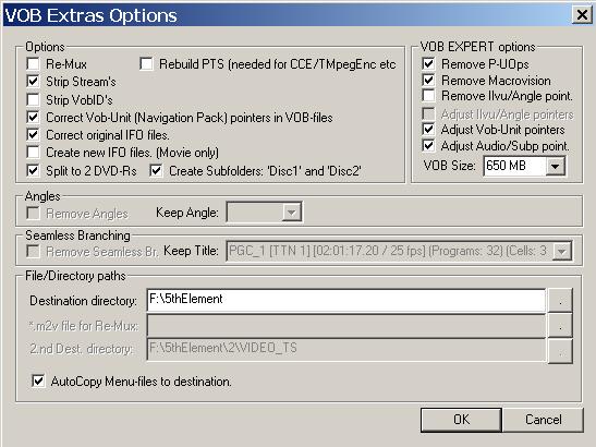

I'm spliting The 5th Element with Ifoedit on 2 dvds. I used this settings with Ifoedit to spilt itVOB size is in fact 1GB)
I striped the unwanted Stream's any let it run.

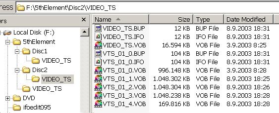

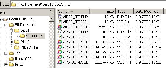

After the strip I got 2 VIDEO_TS files with this in it:
I burnd the second DVD OK, but the first one is hard. Burning with nero gives me "DVD-video files reallocation failed".

I've never seen a "File re-allocation error" in Nero... must be an authoring problem...
Try making sure that any VTS files that are called in the movie (ie...for the THX logo, or FBI warning) are also on each disc....if they are not this will produce that error.
Just to cover the bases...did you get VTS sectors and then save ? Also, after you split the VOB's did you close then re-open IFOEdit.
