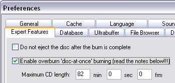

  16. Hi MasterSmurfie,
    I just burned a disc using Nero.
    You have to go to menu item Files then select Preferences
    Click on the Expert Features tab and select Enable overburn
    When you burn the disc you'll get all kinds of warnings and
    at about 275mb Nero will give you an error. It's OK
    The disc will boot in the VideoNow player.
    VideoNow could care less about the file structure, cda files, WAV headers or anything else.
    It reads data directly from the disc.
    Good luck!
    LoLo

  30. hey guys-
    i've been watching this thread on and off for a few weeks now, and i decided to get some small cd's and try it this weekend. my results were very successful (only 2 coasters), although my methods are a little unorthodox. here's what i did:
    1. downloaded VideoThen, VNConvert, and VirtualDub.
    2. captured the avi
    3. opened the avi in VirtualDub
    4. selected Load processing settings in VirtualDub and select videonow.vcf that comes with VideoThen.
    note: for better video quality, 1) select Video->Filters 2) select the resize filter and click Configure 3) set Filter mode to Precise bilinear or Precise bicubic (A=-1.00)
    5. selected portions of video and clicked File->Save Old Format AVI
    6. converted the file with VideoThen
    OPTIONAL
    7. ripped 1st and last tracks (as audio) from original videonow cd, works when you have a laptop cdrom because you can place the cd right on the spindle. i do not think this would work with regulard cdroms. the files will have a .wav extension, but they can simply be renamed to .bin. this step only needs to be done once, you can use the files for other cd's too.
    8. created a bitmap image in paintbrush. the image attributes were 80x80 and color.
    9. saved the bitmap as menu.bmp and ran a script to create 1000 copies of it, naming files in numerical order, 0.bmp, 1.bmp, etc.
    10. copied all .bmp of menu to files subdirectory of VNConvert
    11. ran modified VNConvert.exe to create .bin file with menu. the modified VNconvert ignores the fact that there is no audio.wav file. otherwise i think creating/copying any wave file in this directory will work.
    12. now i had the ripped intro renamed 0.BIN, the menu file from VNConvert named 1.BIN, the converted avi from VideoThen simply renamed 2.BIN, and the ripped ending renamed 3.BIN. i ran VNConvert and selected Finalize Disc.
    13. ran Nero, and under Expert Features, selected Enable overburn...
    14. opened the .cue file with Nero and burned to disc
    i have a Cendyne DVR-105, and like others i could not get it to overburn with any software. fortunately, i have a couple of cd burners laying around, and one of the others worked fine.
    i should note that i actually created many small avi's around 4-5 minutes in length as recommended by others. i just left it out of the steps for simplicity. my actually directory contains 0.BIN, 1.BIN,..., 8.BIN, 9.BIN, 10.BIN where 8.BIN is my last avi, 9.BIN is the ripped ending, and 10.BIN is the pad file created by VNConvert.
    now i have custom videonow discs with the standard beginning, a custom menu, and the standard ending.
    thanks alot to LoLo and Greg for the great software, and thanks to everyone for the information!
