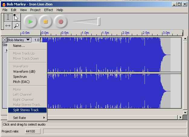

Load the MPEG (mpg or mpa file if you decided to keep it) into TMPGEnc and choose File->Output to file->WAVE file now make sure the audio format is 'PCM 44.100kHz 16 Bit Stereo' NOT MONO otherwise the two channels get mixed together. Now load the wave file you just created into an audio editor (I use CoolEdit which can import MPEG audio but if you like your software free try Audacity)
Once the track is loaded choose split stereo track as shown:
Now copy the English track to the clipboard, delete the Chinese one, paste the copy of the English track back in (so you have two mono tracks now) ensure one track is set to left channel and the other to right channel. Now select 'Make Stereo Track' from the menu where you did 'Split Stereo Track' and save it.
