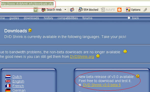

  1. Originally Posted by overloaded_ide
    I think I have the newest version, just downloaded it a few minutes ago. DVDshrink Version 2.3
    Originally Posted by presto
    recommend the latest Beta (Beta 5). It has has a function that does a deep analysis of the disk and lets you get better quality at the same compression
    You stop me again whilst I'm walking and I'll cut your fv<king Jacob's off.
  2. The beta is a big improvement over an allready great program. You can even combine two DVD's onto one.
  3. Well, darn!
    Here I go again, high ho high ho, off to download I go
    I saw that blue page once too, but I got it off a mirror site before that I think.
    Well at least we know 2.3 still works
    Thanks.

  4. OK, got DVDshrink beta 5.
    No problem with that one either, it also worked with my version of nero, burning now.
    Not sure if I like Beta 5 or 2.3 better. Only one rip with each so far. But I know unless I need to use it, I won't be using analyze again! Nearly an hour and that disk was not so big, about 5 gigs maybe. Then another 40 to actually rip it. Not sure I like the auto feature, I might would rather set my own compressions like with 2.3
    But both worked well it seems. I'll watch this disk latter as I will probably be asleep before it is done burning.
