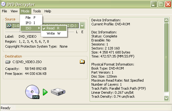

The easiest way to copy a DVD5 to DVDR or a DVDR to DVDR is to make an ISO image with DVD Decrypter and write that ISO image with DVD Decrypter. I cant explain it other way.

Just use Decrypter, Mode>ISO>read, to rip it, when it's done, Decrypter, Mode>ISO>write to burn it. And you can burn as many copies as you want. -

1. Make an ISO image with DVD Decrypter
2. Burn that ISO image with DVD Decrypter
Forget about NeroYou stop me again whilst I'm walking and I'll cut your fv<king Jacob's off. -
