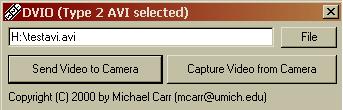

    I am saying DVIO is this easy:
    What could you mess up?
    Hello.

    Wow! Now I could be braindead and still get it right! It is that easy, huh. So I can then just pull up the captured video in mediaStudio and edit?

    * One thing to note w/ DVIO ... should you decide to use this simple gizmo..
    right-click the Caption bar and make sure you select the \AVI format..\Type-2
    * Windows 98: Is limited to 4gigs per file, on a single capture
    * W2K/XP w/ NTFS: Has NO limitation to filesize except your HD's
