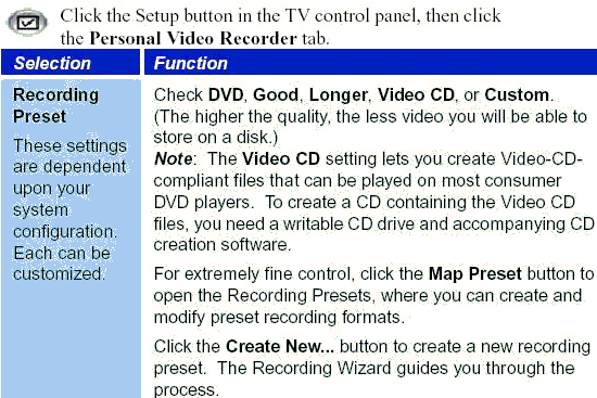

  4. I am sorry, I did not notice I had different version.
    If you have manual for MMC, the solution is found on page 41.
  5. Thank you for the time you've taken, but as I said in my last post --
    I don't see a SET CUSTOM option when creating recording presets either
    unless I am looking through something.... I see a lot of other settings but no SET CUSTOM button or any other setting in PVR preset creations (or editing) where one might alter the codec.

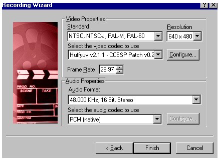

  9. Member djmattyb's Avatar
    Dec 2001
    Seattle
    When you get to this screen, click the Configure button next to Select the video codec to use. From there you can select what codec to use.
