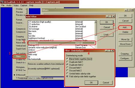

Are you setting up your capture program to not capture in interlace mode? Or if you are capturing from a NTSC source, are you deinterlacing your capture as it comes in?
Hello. -
i haven't seen an option like that before.
how can i do that ?
i use Vdub to capture my videos with PicVideo codec. -
OK, listen:
if i transfer my video trough the firewire, i don't get interlaced images, because the material that i've recorded is in 30p mode ( non-interlaced ).
i don't want to "de-interlace" a video, that is not interlaced, that's ridiculous.
why the video gets interlaced when capturing ? -
The analog video out of the camera IS interlaced.
It plays on a TV doesn't it ? -
