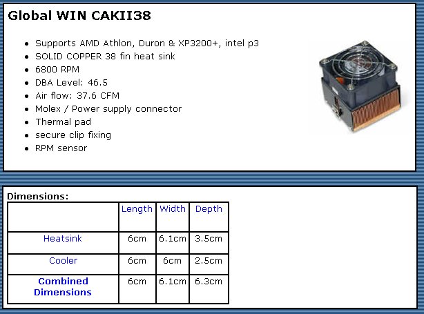

I am using one of these at the moment
The contacting surface is copper (no nickel plating) and it has a nice big fan. Like I say, does the job much better than the supplied cooler. -
Craig,
Looks good.
Haven't been to the site to check, but if I recall the CAKII rated a little lower than other Global Wins, or maybe other units entirely.
No matter. It got you to what you can live with, more importantly, what your CPU can live with.
Cheers,
George -
