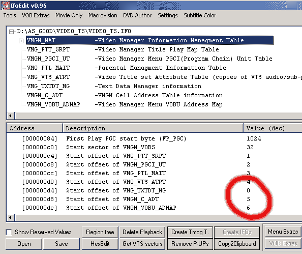

    2. Open the VIDEO_TS.IFO file in IFOEdit and click on the VMGM_MAT. Scroll down and remember the numbers after the txtdt sector. 5 & 6 in this (complex) case. They would be zero in a simple case. In that case, remember the first non-zero above the text sector.

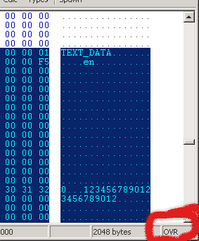

    3. Choose from the menu, edit - paste from, and find the file I provided above.
    4. You'll see this - Type over (do not insert) the 1234567890123456789012 string with your title. You get 22 chars. If yours is shorter than 22, space over the xtra numbers.

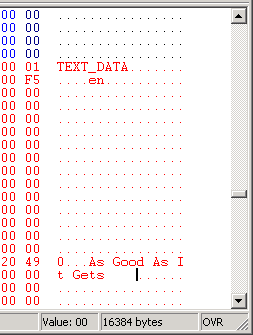

    5. After edit
    6. Update some pointers - Scroll up to the top and look for 000D7. Change this from 00 to the number you remembered in prep, + 1 (3 in this example)

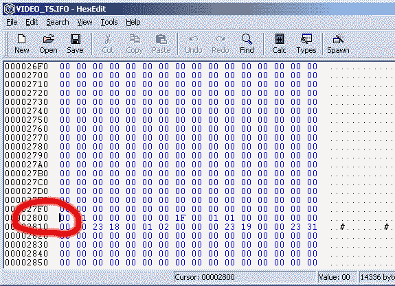

    1. Calculate the sectors - You need 2 values, the old C_ADT and the new C_ADT spot. To get the hex values, multiply sector # by 2048 and convert it to hex using the windows calculator (scientific view). Here are some for ya (4=2000,5=2800,6=3000,7=3800,8=4000)
    2. Edit the VIDEO_TS.IFO using hexedit - scroll to the sector we want (5=2800) to move and put your cursor in front of it.
    3. Highlight (drag) down to the bottom right of the file and hit copy
    4. scroll to the sector + 1 (6=3000) put your cursor in front of it, and hit paste
    5. scroll to the sector (5=2800) again, put your cursor in front, choose edit - paste from, and find the file I provided above.
    6. You'll see this - Type over (do not insert) the 1234567890123456789012 string with your title. You get 22 chars. If yours is shorter than 22, space over the xtra numbers.
    7. After edit
    8. Update some pointers - Scroll up to the top and look for 000D7
    9. Update to the new sector values

  2. Forgive me if I have misunderstood your examples as set in your guide, but i am having difficulties following your hexedit of the videots_ifo file in your example. You have in the original video_ts.ifo:
    start offset of VMG_VTS_ATRT 4
    start offset of VMG_TXTDT_MG 0
    start offset of VMG_C_ADT 5
    start offset of VMG_VOBU_ADMAP 6
    in a simple case, instead of 4056, the reading should be 4000: am I right?
    Then the figure to remember is 4, (first non zero above VMG_TXTDT_MG)
    we add 1 to that figure, then we get a 5 which acording to your guide should then overwrite the 0 in 000D7: why then you overwrite with a 3?
    in the film i am trying to injetct a name, i have in the original video_ts.ifo:
    start offset of VMG_VTS_ATRT 2
    start offset of VMG_C_ADT 0
    start offset of VMG_VOBU_ADMAP 0
    So we are in a simple case. the first non zero above VMG_TXTDT_MG is then a 2. by adding 1, i get a 3: is 3 then correct value to overwrite with at 000D7 for my film?

    The thing to remember is we are adding a sector. In a simple case, the sector can go at the end. Complex sector must go in middle, therefore we have to move the other sectors down.
    In other words, if the values in hex starting at D3 should be:
    04 00 00 00 00 00 00 00 05 00 00 00 06
    You would change them to:
    04 00 00 00 05 00 00 00 06 00 00 00 07
    We are moving down the 05 and 06 sector and putting a new one at 05.
    For YOUR simple case, we are not moving anything down, just adding a sector to the end of the file. Therefore, starting at D3, you would change things to look like this:
    02 00 00 00 03 00 00 00 00 00 00 00 00
