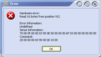

This is ze' error msg that pops up when IC 8.0 decides to coaster a disc:
[/img]
DVDEmperor,
How are you backing up your DVD. Are you using ANYDVD or any other on the fly tool..or are you ripping the movie.?
Also are you writing straight to the DVD Writer. On the write tab I made sure I checked write to hardrive first. I also use DVD Decrypter to rip the dvd. ANYDVD has caused me write errors before. -
I am using DVD Decryptor to extract all the data off the disc then using IC 8.0 to convert. I tell IC 8.0 to write to harddrive first then later on I will burn to dvd-r.
Hopes that answers your questions! -

Seems like IC8 still needs some fixing.Originally Posted by vric -
His ASPI was probably less-than-perfect to begin with. Lots of people have marginally good ASPI layers.
Patin-Couffin, by the way, is NOT ASPI. Serves much the same purpose, at least for burning CD's, but it's NOT the same thing.
- Gurm -
I hope you don't mind me quoting you quoting vricOriginally Posted by ddlooping
but it looks like IC8 is the culprit
I have exactly the same issue here for me regarding Nero since IC8 install and I've burnt well over 250+ with Nero previously with no complaints. At first I just thought it was my IC files or a batch of faulty media as all of my attempted burns were getting exactly the same error at the end of the burn as vric reported in this thread HERE
I never really looked into it as I just used other burning tools instead but now I have things to try and see if I can fix it. I've installed ASPI again and in the middle of a test burn at the minute to see what happens -
Success
I installed ASPI again and burned a DVD no problem using Nero
http://download.adaptec.com/software_pc/aspi/aspi_v470.exe
I wonder if IC8 now works when burning now, so I guess it's back to testing
CDRWin and Nero (various versions) used to exhibit this problem as well. The eventual solution was that the one which used non-standard ASPI (CDRWin) bundled their own alternative ASPI DLL's which were only accessible to their own code.
The problem here is that ASPI became a HUGE mess when Win2k/WinXP support was added, and it's never been entirely resolved.
I have no problems burning with either Nero or IC8, but then again I'm using Nero 6.0.0.11 Ultra. I have no idea how earlier versions of Nero might fare.
- Gurm -
