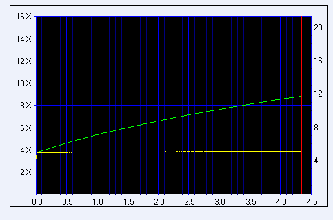

Here are the graphs:
The first graph will be of one of my Ricoh burned disks...which were burned @4x. The Ricoh had almost 4.37 GB's burned to it in about 15 minutes @4x and the results are almost perfect. Most of my other High quality media have perfect results as well. This is just a "benchmark" of what excellent disks should look like post-burn.

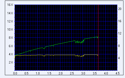

The Second Graph will be the horrific results of the "long..ten" disks A.K.A HQ's that meritline is dumping off....as well as allmediaoutlet and Rima under the "EXTREME" name.

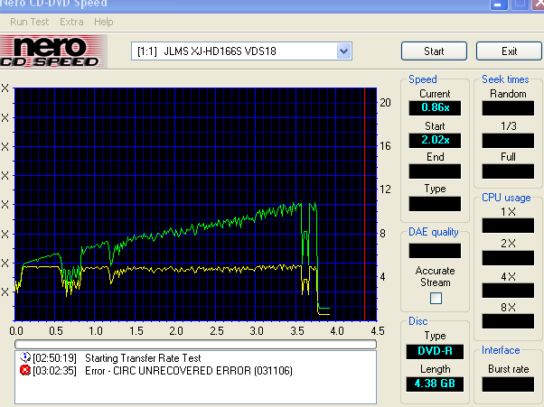

The third graph will be of the "3rd" formula. Although the "3rd" formula is not PERFECT....the very small jags are insignificant to affect playback in any way.
Ricoh @ 4x
Long..Ten 100% Crap @2x
Considerabley better 3rd formula burned @4x
