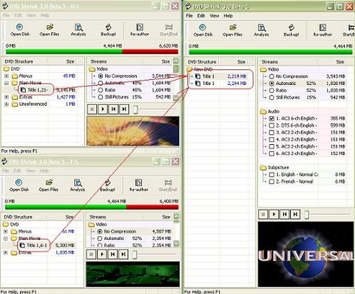

  5. Since DVD Shrink 3 can handle 2 or more sources......
    Two sources 10GB-------------------------------------->on a DVDR
    https://www.videohelp.com/forum/viewtopic.php?p=623650&highlight=#623650

  7. Kelso!
    If you clicked on the link under my pic you could see that I did the same but much simplier,
    no need to use 3 windows.
    Please read it.
    Originally Posted by tompika
    WINDOW1. is for opening the DVDs (or files) and dragging titles from
    WINDOW2. will contain the final jobs
    Here's what I do
    - Launch DVDShrink that opens WINDOW1
    - Open DVD1(or file) click ReAuthor that opens WINDOW2
    - Drag(or copy-paste) your title from WIN1 to WIN2
    - Go back to WIN1, open DVD2(or file)
    - Drag(or copy-paste) the title from WIN1 to WIN2
    You can now close WIN1
    Deselect the audios and subtitles you dont need
    Backup, Deep Analysis (otherwise it will suck)
    You stop me again whilst I'm walking and I'll cut your fv<king Jacob's off.

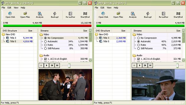

    So...what does this look like? 18+ Gig reduced to 4.3 Gig? Ai Yi Yi! Must be like 3rd gen VHS ep...
  10. If you take a look at my pic (above) you can see
    its the main movies only 10 GB
    I can tell you it looks like a SVCD

    Must be my eyes but when I tried to shrink a 7 Gig DVD to 4.3 Gig, the picture was unacceptable to me, so I now just split them to 2 discs. I do have lots of SVCDs and they never look as bad as 10 Gig reduced to 4.3 Gig would, at least not on my 27" Sony and at a viewing distance of 10 feet. Nice guide though....
