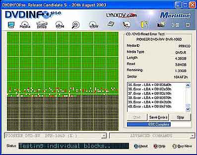

  10. Thank you for this advice, it seems logical to me that this is the most probable cause, here is a jpeg from DVDinfo of a copy made last night. Note the amount of read error evident (unreal isnt it!)
