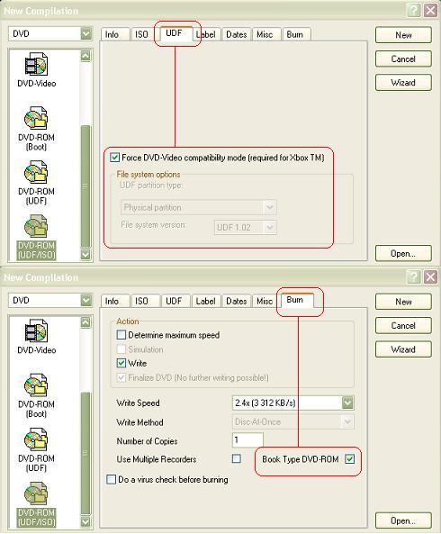

    In nero ther is also some sort of a force compatability for the X-Box. I have never user id cause i done have a box, so i cant test it, have you been selection this option. I am at work now and i cant remember what the function is called exactly, but it us under the burn ISO UDF function.
  4. Generally speaking, "compatibility mode" means the book type code is set to a value that fools players into thinking it is a replicated / retail disc. This helps the disc to be compatible on some players but does nothing for newer ones. This may be the scenario that applies to the Xbox.
  5. Originally Posted by PyrosofT
    In nero there is also some sort of a force compatability for the X-Box.
    YES, there is
    Originally Posted by freestyler
    Generally speaking, "compatibility mode" means the book type code is set ...This may be the scenario that applies to the Xbox.
    NO, they are two different things.

  6. @ tompika:
    where is the "Book Type DVD-ROM" option??
    i am using nero 5.5.10.42
    another question.
    if i check the "Force DVD-Compatibility mode (required for Xbox TM)", will the dvd-r's play on standalone dvd players as well?
  7. My statement is correct, your observation applies only to Nero and not to disc recording in general. On top of that, we are using different versions of Nero, my friend. Now hands off my penis before you pull the jam out of it
  8. Originally Posted by deh707
    It appears when a capable plus drive is detected. Ricoh types so far.
    If i check the "Force DVD-Compatibility mode (required for Xbox TM)", will the dvd-r's play on standalone dvd players as well?
    It should play.
    The differece between
    - DVD-Video
    - DVD-ROM (UDF/ISO) 1.02
    - DVD-ROM (Force DVD-Video comp. mode for Xbox)
    compilations is one of Ahead Nero's mysteries
    You need to find out wich one works for you.

  9. Originally Posted by freestyler
    LET'S SEE HOW CORRECT YOU ARE
    1. The original poster uses NERO and have a question about how he can improve the compatibility with XBox.
    2. Pyrosoft tells him there is an option in NERO toForce XBox compatibility mode
    3. Your answer
    COMPATIBILITY BITSETTING and
    FORCE XBOX COMPATIBILITY MODE (NERO)
    ARE NOT THE SAME!!!
    You're obviously talking about a DIFFERENT thing that has nothing to do with Nero's XBox option (as shown on the picture) and not entirely correct.
    What do you mean "does nothing for new ones"
    I've tested dozens of players with DVD+R and DVD+R(with ROM booktype) so I really know what different it makes. Lots of brand new models would play DVD+R only as DVD-ROM.
    I suggest you visit www.dvdplusrw.com for more information
    And get some firsthand experience before stating something
    I'm referring to a totally different compatibility mode that helps readability on older standalone players, HP +R drives inherently write in this mode and quite possibly a few others, contact HP support if you're a disbeliever.

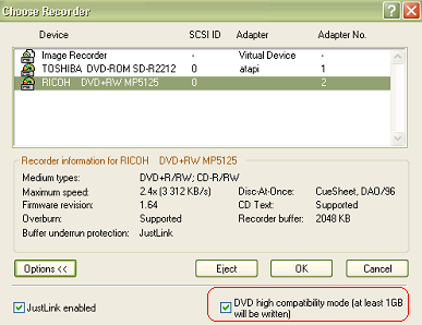

    Nero has been able to create DVDs playable on the XBOX since, v5.5.10.7. You must tick high compatability mode though. Also use the latest version of Nero possible. I don't use v6, I'll wait a little while for the bugs to iron out, I use 5.5.10.42
    I also use DVD-R and along with my version of Nero play happily on my XBOX.
  15. Originally Posted by roach1976
    As shown on the screenshot I posted above.
    The high compatibility option is a different story and I think it's selected by default
    And it should be selected
