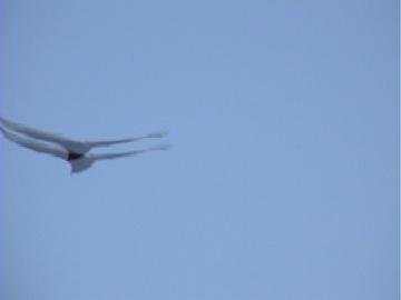

So I just bought a camcorder (Sony TRV33), and tried to capture movie with firewire to my laptop. I tried Windows Movie Maker and Adobe Premier 6.0 and everything I found on the internet for free. With all these softwares I got the same problem, when I play back these captured avis (with WINDVD or Windows Media Payer) it looks really bad, especially, when there is movement and sharp contrasts in the picture (when it's steady, it's quite good, but still not perfect).
BUT, when I played back the captured files from the Adobe premier through the firewire, to the camcorder, and then to TV, the picture was perfect on the TV!
I chose the best quality setups, read everything on the forum, but still could not figure out what's the problem!
Here is a captured image from my video, maybe it helps:

The reason you could not find the problem, is because there is no problem. Your video on your camera was taped to be played on a television, which uses a display process called interlacing. You computer sees this differently than your monitor. Look up interlacing for more detailed description.
If you want to play your video on your computer, you must de-interlace the video, but if the final product is for TV, do nothing.Hello. -
What TK said is correct. You could also play your video files in PowerDVD which actively deinterlaces the content. I firmly believe that interlaced video on a television looks better than progressive video on a computer monitor unless the video has been progressively encoded.
Proponents of progressive video sometimes fail to realize that almost no movies are progressively encoded. -
Thanks! Yes, deinterlacing was the solution, but I still don't understand everything!
1. Video is still not as good as on TV! There is still some noise at the edges of the objects when they move! Is it normal? That's the best quality I can get on my laptop? Movies on DVDs looks perfect! What's the difference?

1) This could be many things, including the codec used to play back. Some say the default MS codec is not very good for playback, though I find it acceptable. There are a couple of free DV codecs listed in the tools section you could try if you wanted to.
2) If the source is interlaced (DV is as you know) and your target display device is also interlaced (TV is), the leave to video interlaced. Do not de-interlace unless you absolutley must, it can introduce artifacts.
