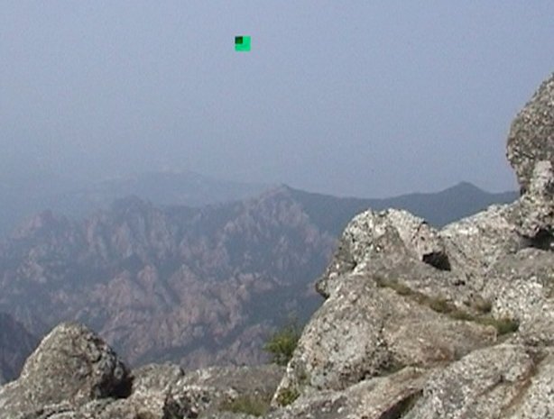

  8. Just to follow up.
    I have been doing a lot of testing and optimization, verification of drivers, defragmenting etc the last days.
    However the problem still exists.
    I am still not sure this is what is categorized as a dropped frame (but what do I know), so I have added a picture of what the problem looks like.
    Is this the result of a lost frame?
    If not, what is it then?
    Cheers
    Stephen Slot Odgaard
  9. Member The village idiot's Avatar
    Apr 2002
    Adrift among the STUPID
    Oh?.... How often does the occur? To me it looks like a problem on the tape. Sometimes tape damage can look like that. Is it always in the same spot?
    If it is some sort of tape problem, it is likely that you will not see it on your TV. The encoder will "cover" some of that damage when it converts to analog. When you transfer to your computer, there is no error correction, so any problems will be transfered. Have you tried cleaning the heads on the camera?
    Wish I could help more, but now I'm kind of out of ideas.

  10. Hi,
    Thanks for your suggestion. You are right I dont see the result on the TV, but neither on the Camcorder LCD screen which I would think was direct digital feed. Or is this converted to analog also?
    Each capture seems to result in noise at different locations, which until now has made me think it is something in the transfer process. Further the DV has not been used that much, so for I wouldnt think it needed cleaning already.
    Cheers
