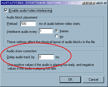

  10. Member mats.hogberg's Avatar
    Jul 2002
    Sweden (PAL)
    The audio is happening before the corresponding video. ie. you *hear* what the people say then you *see* them say it. The sync problem is present right from the start - easily evident in the first 2 minutes of a 90min long movie. Once out of sync it does not appear to get any worse - ie. it is shifted and remains shifted by the same amount all the time
    OK! Now this is an easy one to fix. It seems like when interleaving the audio and video stream in an AVI, the audio stream doesn't have to start at the same time as the video stream. In your case, the audio stream starts a bit later than the video stream. When you extract the audio, you lose this "delay" of the audio, so you have to compensate for it when frame serving your edited audio together with the video.
    Brute force method is to actually insert some silence in the start of the wav (after shortening it as a step in the frame rate conversion) before saving it out, or you could choose wav audio in VDub, Full processing, "No change" everywhere in Conversion, and set a ??? mS delay in Interleaving. This last method, I haven't tried, but it ought to work. The first surely does.
    /Mats

    Okay! Finally it feels like I might be getting somewhere. You're being a great help and I'm very appreciative of you hanging in here with me on this.
    I'm trying this in VirtualDub first because I don't know how to add silence in GoldWave. The VDub log keeps reporting "Dub: Processing has not cycled for 10 seconds -- possible livelock." over and over again. If I switch off the audio skew correction it proceeds as per normal.
    I guess this means I can't do it with VDub which is a trifle annoying. Can you give me advice on how to do the same thing in GoldWave?

    In Goldwave (version 4.26), just open the Edit menu and select Insert silence.
    The function pops up a dialog where you can specify how much silence you want added. The silence will be inserted at the leftmost marker (which is at the start if the wav when you open a wav - right where it should be).
    Hang in there - we'll soon have this fixed!
    /Mats

    OH MY GOD It works!!!!!
    I can't believe it! Mats Hogberg I love you!
    You're a very lucky man. If it wasn't socially unacceptable for men to kiss other men, you'd be in some serious trouble right now lemme tell ya!
    In case anybody's interested the 2 min test I've done using the audio time produced by VirtualDub results in the audio being just ever so slightly late (*after* the corresponding image) which means I've added just a tiny bit too much silence at the beginning. For this reason I tend to think that the audio duration reported by GoldWave (which was about 2/10ths of second longer IIRC) is the more accurate of the two.
    I'm going to do another 2min test this time with the audio adjusted according to the GoldWave reported times instead of VDub's. I think this will be the last test I do
    Thanks for everyone's help. It is greatly appreciated.
