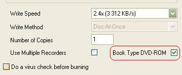

  6. Well, the first thing I tried didn't work. I used the DVD-ROM UDF setting. There was also a UDF-ISO setting, should I have used that one?
    I am going to go back and try it using the check box you just showed me for Book Type.
  7. Use DVD-Video compilation

  8. Thanks, I went to dvdshrink. I am burning the UDF-ISO right now. If that doesn't work, I will try the other DVD-Video, then I will try to mess around with the other options.
